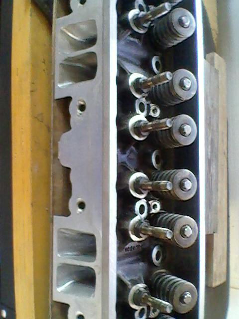

I now have $315 in cam ported heads Lt4 springs retainers Locks Seals and Timing Chain.
http://wumingta.tripod.com/pub/porting19.jpg
http://wumingta.tripod.com/pub/camsprings.jpg
