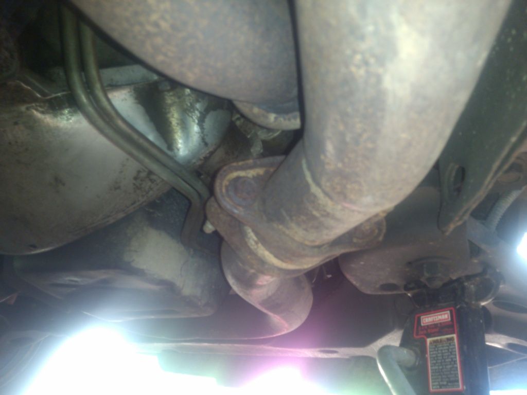

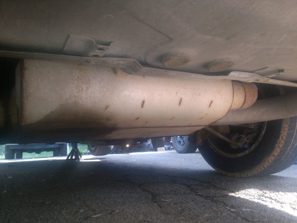

I know I need a muffler with a inlet and dual outlet(correct me if im wrong im still learning Camaros) I found a flowmaster 10 series with that set up but the summit racing site doesn't say it will fit.

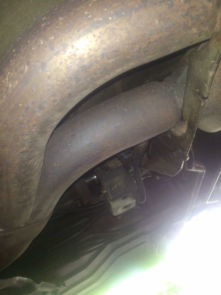

I currently have a flowmaster 80 series which sucks IMO.Here is my set up with the 3in exhaust.
And here is the 10 serie flowmaster

only the 80 series will work because of the crossflow design. It has an outlet on both sides with an inlet one side. The 10 series has both outlets on the same side with the inlet on the opposite.
