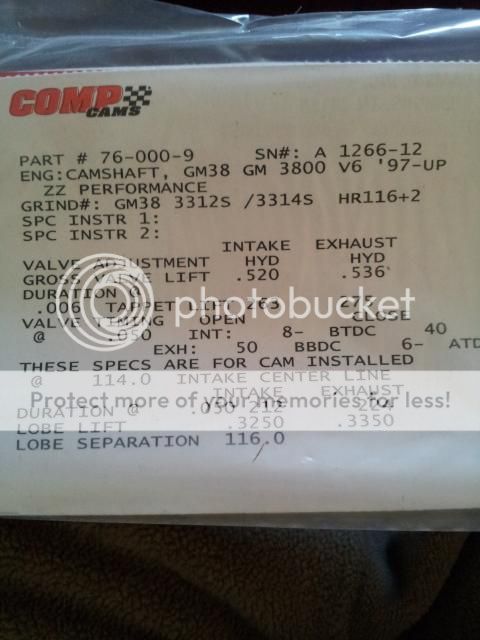

XP cam installed, Double Roller, Studs. Figured I'd mock up some other stuff...

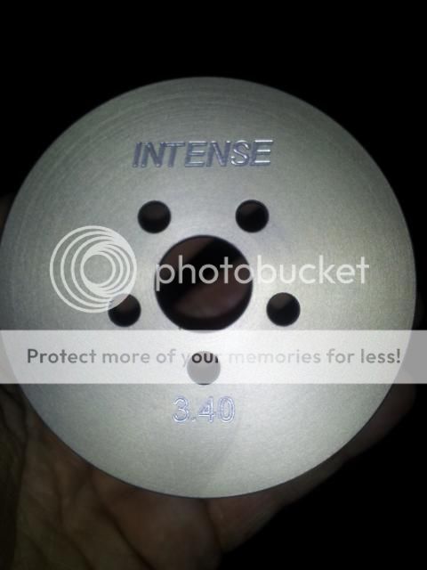

Also pulled that big ol 3.8 pulley off for a MPS 3.4 setup.

I know stock GTP's running 8.5:1 are rated at 260hp. Just top swapping a non supercharged motor will give you the all the perks WITH 9.4:1 compression. There's an instant 5% increase putting it at ~275-280hp. Stock cam lift is intake .413/ exhaust .413. The XP cam I am running is .520/.536 with the 1.6 rockers. Decent difference there :D With the porting work to the blower, intake, and heads along with headers and higher compression and the pulley drop it should pull decent numbers. :)Probably pull my LT1 car pretty easily I hope.

Yes, smaller supercharger pulley can mean more knock. Because you are building up more HOT dense air. Main thing that kills knock is getting the air as cool as possible. Cool dense air makes for a happy motor. Things I did to help with that was install headers to help flow. I deleted my EGR so I'm not sucking exhaust gas back into the supercharger. I will install a fenderwell intake to move the air filter into the big empty space between my front bumper cover and inner fenderwell. After the fenderwell intake, I'm hoping I can drop a pulley size or two.
For each supercharger pulley change (.1") equals ~7hp increase. Each degree of timing due to Knock Retard equals ~5hp drop. So if I am running a 3.4" pulley right now with 0 KR at WOT I'm possibly maxed out. If I put a 3.3" pulley I might see 2* of KR at WOT. What that means is I gained ~7hp from the pulley drop, but I'm losing ~10hp from the timing change... So not only am I possibly causing damage to the motor with KR, I'm ultimately losing ~3hp running a smaller pulley.
